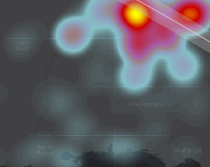

I am running ArcGIS Pro 2.0.0 and every time I export a heat map I am working on I get what I can only describe as 'tears' in the heat map imagery (see attached images). I have tried putting the heat map symbology as the top layer, exporting as different file formats and changing the scale but have not achieved any positive results. Has anyone had this issue? Does anyone know any fixes?

is this only during export? it looks like processing being clipped to an extent of a raster layer

Addendum: Ok - I found what seems to be a temporary work around. I exported as an emf and then converted it to a jpeg in other software. No tears or flares!  Good luck.
Original comment: I'm having the exact same issue! Also, when I do get the heatmap to export without tears, it has "flares" instead... picture posted.
