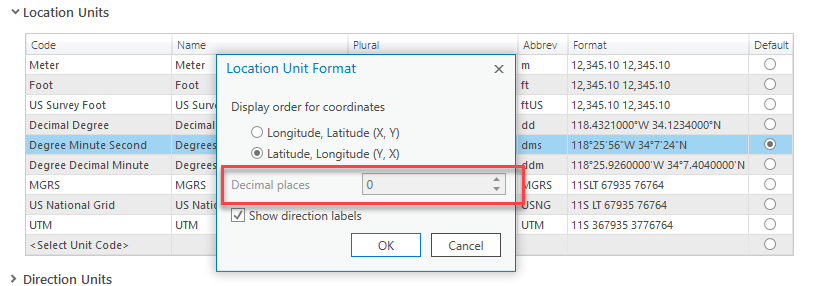

How do you add decimal places to DMS Coordinates for the map display in ArcGIS Pro?  see picture below.

Thanks for the reply Dan. I see there is a place to set the number of decimal places for DMS, but it is grayed out. I wasn't sure if I needed to do something to activate it or if that's just the only setting for DMS.

Unfortunately, you cannot change the DMS decimals units :0(
Here is a workaround to display decimal places as Degrees Decimal Minutes.
Open ArcGIS Pro and create a new Blank project (TestDecimals)
Close Catalog View
Insert a New Map (By default the units are set to Decimal Degrees, I updated to DMS)
However, you can switch to a different set of Units and change the number of decimals digits.
Click on Project > Options > Units > Expand Location Units
Expand the fields of the table, so you can read all the field values
Right click on Degrees Decimal Minutes > Click on Set unit format
Under “Display order for coordinates:
Verify that the radio button for Longitude, Latitude (X,Y) is checked
Under “Decimal places” set the value to your desired number of decimals places (3)
Click “OK” twice
Click on the back arrow to return to the display
In the Content Pane, double-click on the Map to open its properties
Under General > Display Units click the pulldown icon > Select Degrees Decimal Minutes
Click “OK”
Verify at the bottom the new Units and decimal places.
