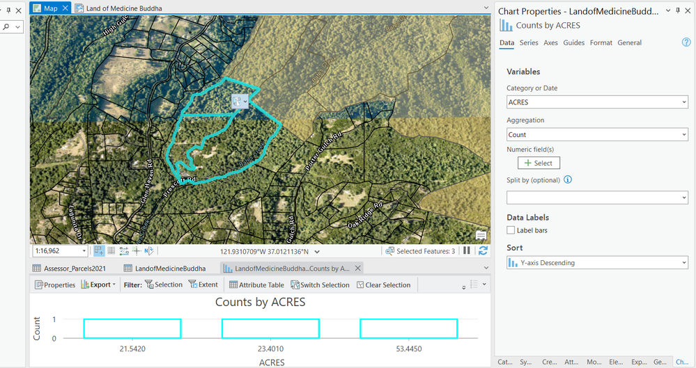

nkobel
Yeah this is very annoying. This thread talks about your question (you must right click your data in the TOC to create a histogram chart), but for me I can't get my selection to be differentiated from my dataset.

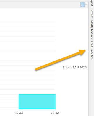

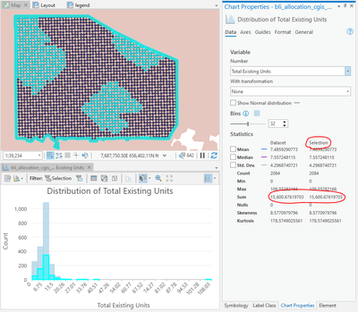

rgmingo
All you need to do is open the chart properties pane

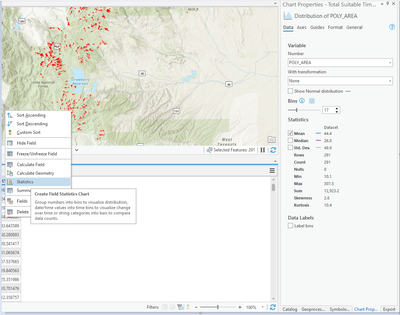

SamDearing
I found that when right clicking on the field, if I choose "statistics" instead of "calculate field," the chart properties pane will come up on the right side and show you multiple outputs, including the sum.
