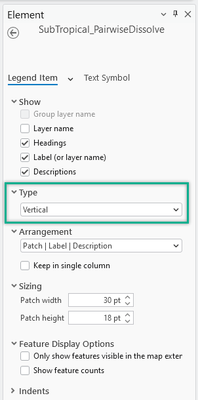

AubriOtis
Would a vertical legend item type work in this case?
Cheers,
Aubri
DEAF_PROBERT_68
Honored Contributor
Which version do you have for that ? I have 3.3  currently

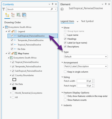

AubriOtis
Legend item types were introduced in ArcGIS Pro 3.1, so you should see them in 3.3. You do have to have the legend item selection in the Contents Pane (not the legend itself) to see those properties.
