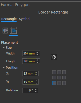

In my original layout all the units were in mm, I don't recall changing any settings to make this happen, I assume these were how the units are to begin with.

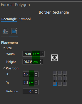

I am now creating another layout, but when i customize my elements in this new layout the settings are all in cm, and I have no idea why.
I am wanting to make these uniform, and use mm in both.

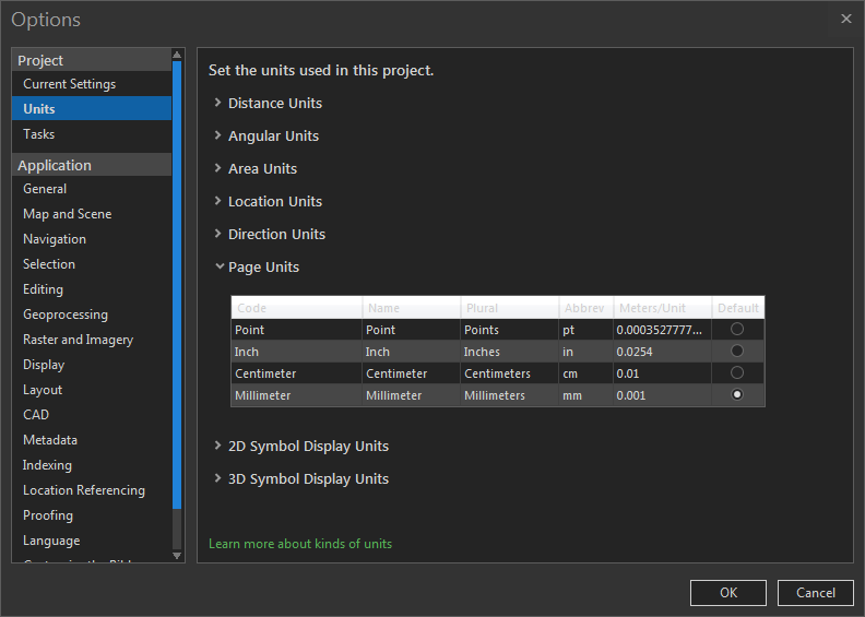

I found in the settings this page, I have set to mm, but this has had no effect:
Can someone please point me to the setting I am looking for??

TomBole
Ben, Kory,
The page unit setting under Options only applies to the default page unit for a custom page size. It should not affect the page unit of any existing pages or the page units of any pre-defined layout template (like those found in the New Layout gallery) or any layout file (.pagx).
