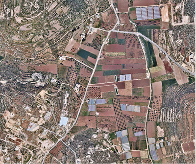

How do I make the mosaic completely equal in color and characteristics with the original photos during the process of publishing orthophotos?

@DanPatterson  yes I did, unfortunately it didn't work! the result above is after the color balance mosaic dataset!

From the tool's description, it looks like you might have to play with the parameters of the tool to approach a match.

Are you making a 3 band mosaic dataset or 4 band? The lightness of your output leads me to believe you may be using the 4th band?
MaramGhannam
@Anonymous User yes 4!

did you use
Analyzing a mosaic dataset—ArcGIS Pro | Documentation
to check for anomolies?
And did you specify the number of bands?
Create Mosaic Dataset (Data Management)—ArcGIS Pro | Documentation

@DanPatterson yes i did use it ! the result is the same as above! 😕

Process it without the 4th band.

Tech Support should be your next step so they can examine your environment and data to see what is going on.
