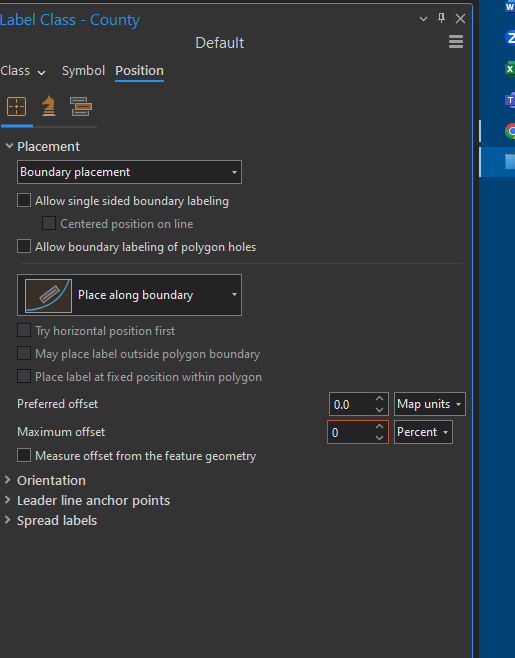

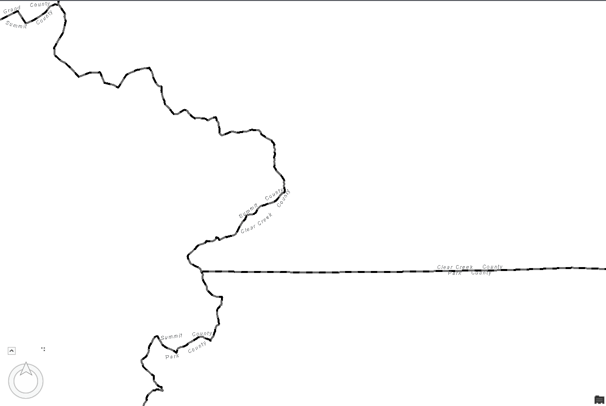

Hi, I am working on county and I want the label to be follow the line ; however, this is not what I wanted... Is there somebody out there that worked on them and success get them correct have a better solution or suggest to me a better one ?
Here is what I put the labels as a placement "Boundary Placement" ... But the problem is the list is very limited to choose from . It would be NICE if ESRI could build more different placement such as follow the line, offset , hortizonal , vertical, etc !
Can somebody out there point me to fix the problem ? I do not want to covert them to Annotation as it is a lot of work to do.

Screenshot here :
