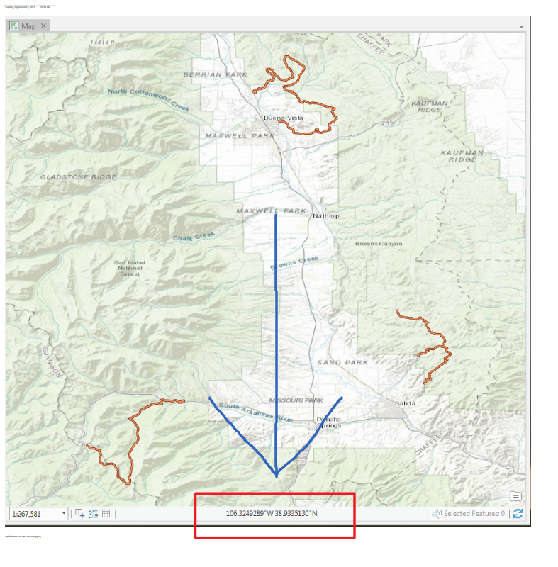

Have a question.  I am starting to work on PRO and I do have a question.  How can I change from dd to UTM  in the Map  tab ?  The reason I am asking is because when you have the layers from dd to UTM and wanted the caption to display label in UTM.  So you know the Layer can be display in UTM and they are in correct.  Yes, I am aware that you have to go to the layer's properties and then on the left side on source to check for the spatial reference.

I dont know why it is displaying in 13S instead of 13N ?

Yes, I am aware of that that if you go north above the equator it should show N. but my question why does it show the S ?
I pull it up on my ArcGIS 10.3.1 and it still shown in 13S too .  Ugh...

Let me back it up a little bit.  I got these KML from another co-worker and came with it and I convert it from DD to UTM using the projection in PRO. Did something happen somewhere ?

Hold on....I am looking at the picture again and I can see that it is 13 N but it also shown S as well ?

The 32N and 40N along the left-hand side is referring to 32 degrees north latitude, and 40 degrees north latitude.
In those 8 degrees of latitude is the latitudinal zone S.  If you move north to say 41 degrees north, you'd be in latitudinal zone T, and if you were still in the same east-west/longitudinal position, the display would read 13T.
