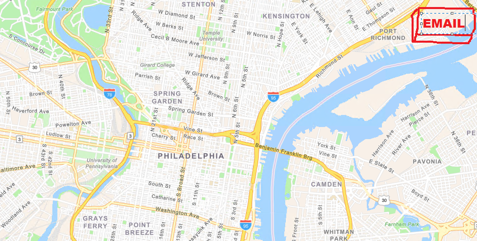

I am trying to create a button within the map view for opening outlook with the email address of a selected point pasted in the TO: line, this is for both pro and portal. Our data points contains an email field and the button will take the email address from the field of a selected point and automatically open and paste the address to the outlook TO: line. I have a picture of what I am trying to accomplish, attached to this email. Instructions or documentation on this topic would be appreciated.
Email button in upper right.Email button in upper right.

I don't know if and how you can create a button like that.
But: You can configure the popup of the layer so that it shows a clickable Mail link. That works for Layers in a web map /app (through Portal). It doesn't work in Pro for me, but that might be restrictions of my institution, maybe it works for you...
