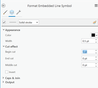

How do I change the length of the first section of the leader line? The portion highlighted in the red rectangle.

HenryUnderwood1
This can be adjusted by applying the "cut" effect to the leader line symbol. In your case it would be the end cut.
