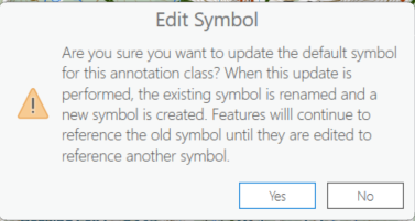

This is the point where I might be doing something wrong. I get the following message at this stage:
I went ahead and clicked "Yes", but the font color remains unchanged.

You were on the right track, but as the warning message stated, "Features will continue to reference the old symbol until they are edited to reference another symbol."

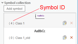

So now that you've created a new symbol, you need to update the attributes of the existing annotation to reference the new symbol. Note the id number of the new annotation symbol in the symbol collection you created in the database.
Then update the Symbol ID attribute of the annotation features to the new Symbol ID.
