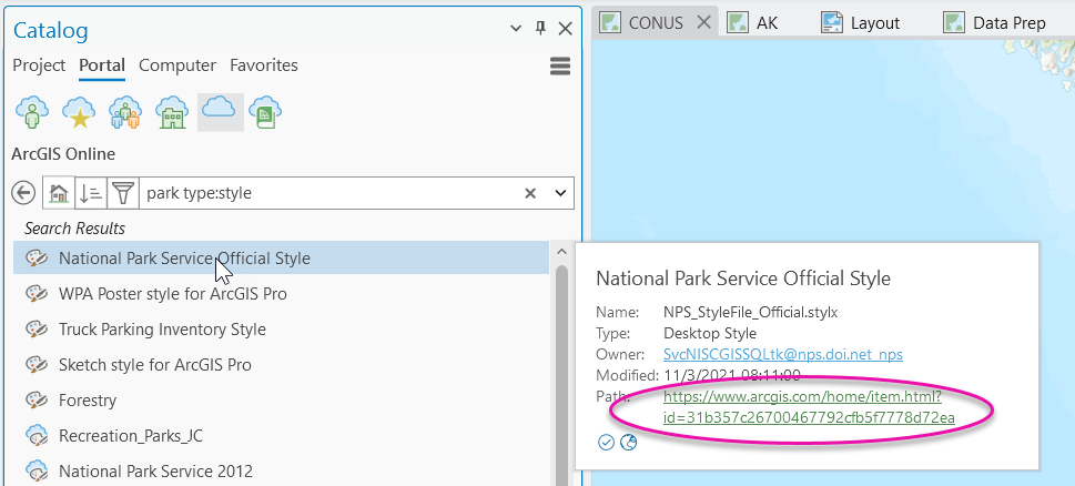

To find styles posted to ArcGIS Online (AGOL) or Enterprise, follow these steps:
  • Open Pro and sign in to AGOL or the Enterprise Portal you want to use.
  • NOTE: I was seeing a lot of symbols in the Living Atlas signed in to AGOL and none using my org's Enterprise Portal. I'm not sure why they wouldn't be the same, but they were.

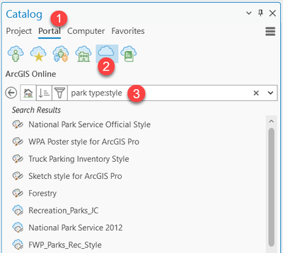

  • Open the Catalog pane, choose Portal, click on the Living Atlas icon, and type your search term plus "type:style".
You will get a bunch of styles. They may or may not be any good, so you might have to sift through them. If you hover your mouse over one, it will give you a link to its item page, which may have some useful information.

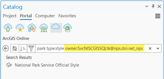

If you know who published it, you can add that to the search terms:
To use it, right-click on it. The option "Add Style" is the only menu choice.

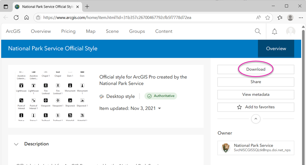

Alternatively, you can download the .stylx file from the AGOL/Portal item page and use it like any other style file:

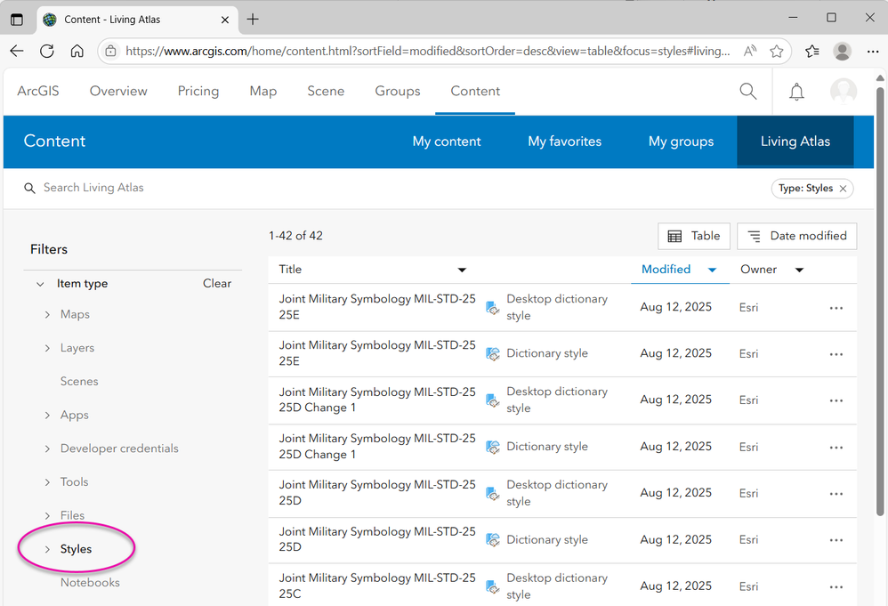

It might be more user friendly to do your discovery in a web browser, using the "Styles" filter on the left:
Once you've found a style this way, it should be pretty easy to locate in Pro using the name and owner parameters.
