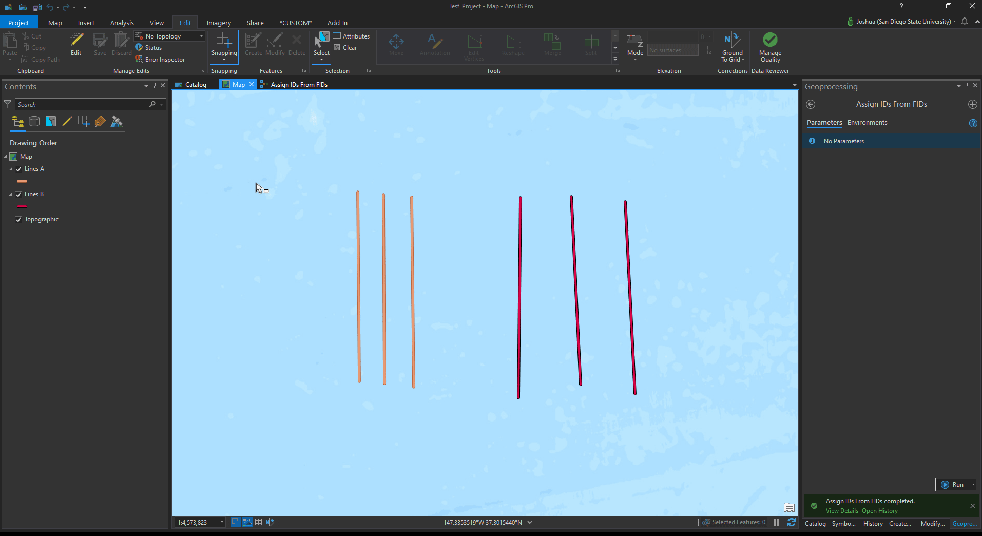

I have a small model that only runs Calculate Field (Data Management) which I would like to have the option Enable Undo. I'm not able to undo edits when running this model, even when enabling an Edit Session manually. I can only undo edits if I have already altered a feature or record in the current session.
ArcGIS Pro 2.6.2
Windows 10 x64Example cannot undo edits
