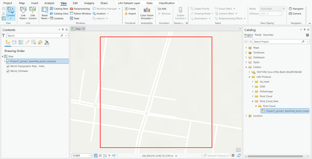

@wizgis but this requires LAS Dataset as input and that is what "Convert LAS" creates as output. i am not sure if my LAS dataset is correct as running the "Convert LAS" tool just creates a red rectangle on the map and then when i run the "LAS to Raster tool", it fails stating that cannot create output (Error 000210)

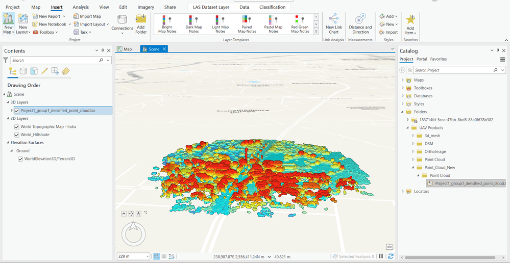

So I had a sample LAS file at my end and as you mentioned earlier nothing shows up when we add it in the map viewer as screen in this screenshot.

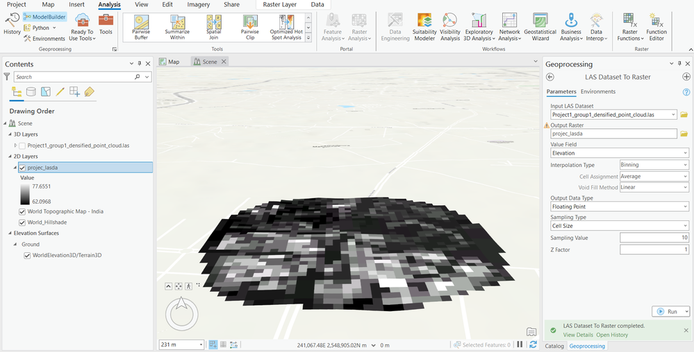

However, if you insert a local scene points show up and then if we run the to Las to Raster it works as shown in the following screenshots.
Can you try the same workflow at your end and see if it works.
