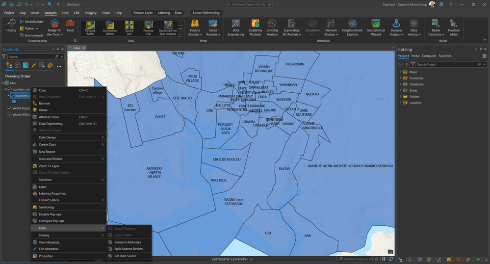

I clicked OPEN IN ARCGIS DESKTOP, then OPEN IN ARCGIS PRO. A pitemx file was downloaded. I opened this in ARCGIS Pro. Now I need to convert this data to a shape file so that it can be used in other tools. When I right click on the layer in contents pane, there is no "Data - export" option. Is there a way to save the data as a shape file?

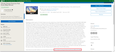

Hi @GraysonAlexander. It looks like the Map Service on which this data is based is not configured for exporting. However, it does appear that the original data on which the Map Service is based can be downloaded from the link listed on the Item Details page (highlighted in red below.
 Go to that link and scroll to the bottom where it says Data Access and try to download from there. That'd be my recommendation.

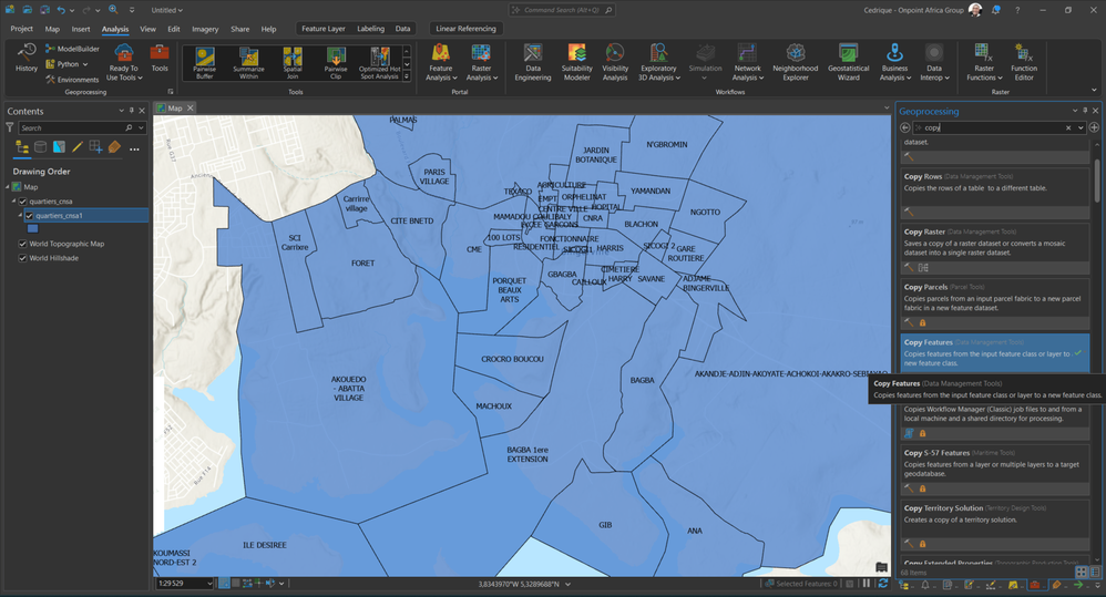

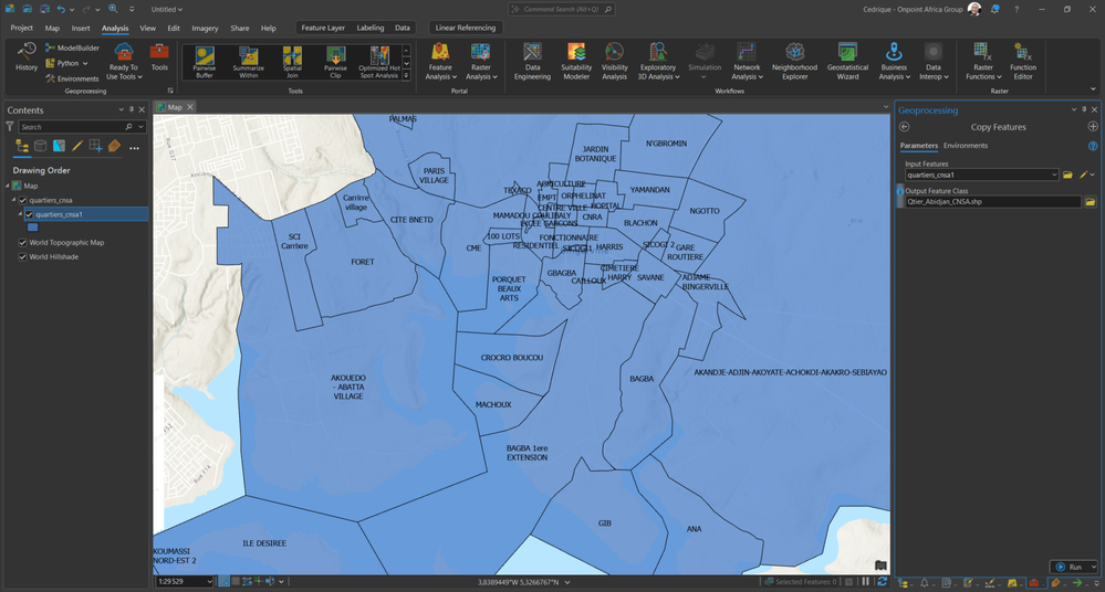

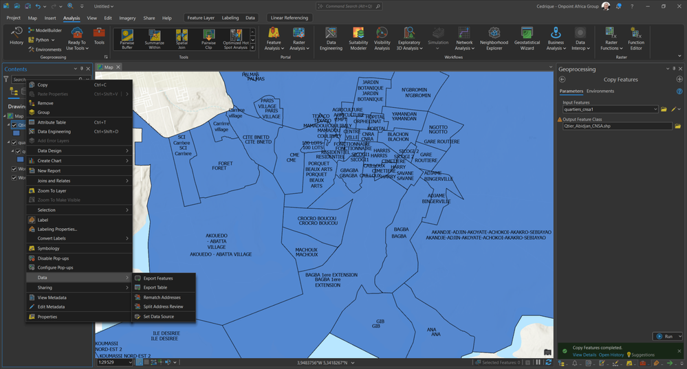

Every time I find myself in this situation, I forget how to export a Shapefile from a .pitemx file, even though I've done it before. I ran into the same issue again today, on 09/25/2025, and finally remembered the solution. You just need to open the Geoprocessing Tools, search for "Copy Features", and that’s it!
Can't export the shapefileCan't export the shapefileCapture d'écran 2025-09-25 095250.pngCapture d'écran 2025-09-25 095944.pngCapture d'écran 2025-09-25 100039.png
