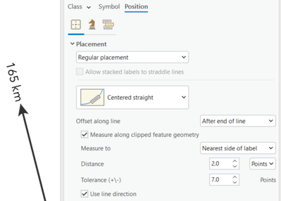

JesseWickizer
To place the label at the end of the line, change the Offset along line setting to After end of line or Along line from end.
