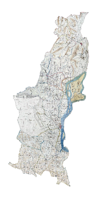

Here is what the maps look like before mosaicking (individual rasters):

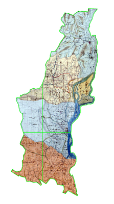

After mosaicking:
I am wondering why such a significant color shift occurs. The Color Balance function does not change the rendering, and adjusting the Stretch does not truly reduce the differences.

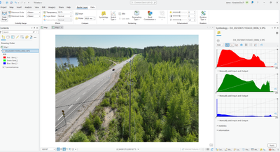

  2. Then look the actual pixel values of your data compared to Look Up Table which in Esri terminology is Custom Stretch. You should see a clear difference in pixel values between images in this kind of visualization: tikola_1-1770299294322.png
  3. Then the task you need to do is somehow feed streched values as a mosaic input and that should output the correct result.
So in generally it is important to understand what is a true pixel value/color of a data and how software stretches that to display. So thing your eye sees may not be that actual pixel value but rather a software based visualization of it. All GIS/Remote sensing tools act in this way and it is user task to control that. Just guessing possible mosaic tool settings makes no sense you need to understand where problem lies and then trying to find right solution to problem.

I really like the color rendering of the individual rasters (first image), and I would like the mosaic to display the same way. The corresponding stretch type is Percent Clip, but when applied to the mosaic, it produces the rendering shown in the second image above.
