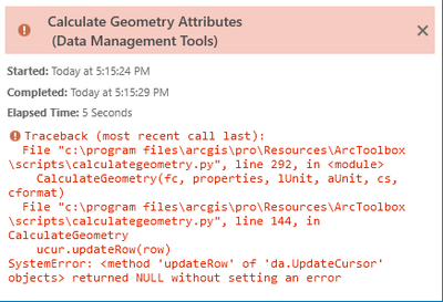

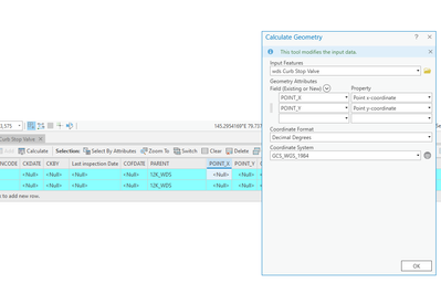

Hello Community,
We have recently migrated to ArcPro 2.8. I published my editable feature services and my team was up and running. We then added attribute rules to our Branch Versioned DataBase and again were grooving along. We then made some additional modifications to the attribute rules. Now the ability to calculate geometry on ANY of our feature classes seems to throw an error. It works on Shapefiles and file GDBs, but seems to no longer work with our feature services. Has anyone encountered this? Any suggestions on further troubleshooting? Just trying to add the X and Y in WGS84/Decimal Degrees.

ASHAFFER
Unfortunately not. It seems that ADD XY Coordinates appends two new attribute fields to the feature class. We need to update X, Y, Centroid, Start and Stop of line, etc. in pre-existing fields. We previously calculated these with Attribute Assistant Rules. We have not come up with a way to do this in Attribute Rules (YET). Our workaround was that we were calculating them through Calculate Geometry Attributes for new features as they came in. We also have several integrated software systems, one of which relies on those coordinates to place workorders on the map.

HusseinNasser2
Hey @ASHAFFER
would you mind sharing the attribute rule script along side the error you get during execution?
thanks
ASHAFFER
Hi Hussein,
I will see if I can snag that for you and post here. Though I was recently informed that this is due to BUG-000137849 😞
