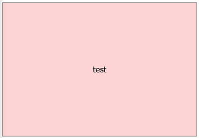

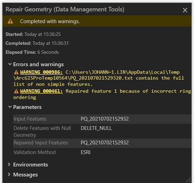

My first guess wasn't far off. Though the feature do have geometries, they're corrupted. Recognizable  by Shape_Area = 0.
Running RepairGeometry solves the problem:
Don't want to go through the code right now, but inserting something like the line below after you created and filled the feature class should suffice.
https://pro.arcgis.com/en/pro-app/2.7/tool-reference/data-management/repair-geometry.htm
arcpy.management.RepairGeometry(in_features)

Hi Johannes,
That seemed to fix the issue! Thanks for the suggestion. I've since updated my script and all works well. I hope you have a great day as well.
