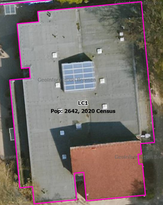

I've got a stacked label with multiple fields that I've been building in Arcade. Is there a way to add a halo to just some of my text, via tags or another means? Right now the whole thing is haloed, but I only want the top line to have that effect.

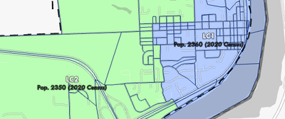

Your only options seems to be creating two label classes. But then they will be positioned independently from each other. You can force them into the format you want with a a bit of fiddling.
For points, it's easy: the haloed class on top, the other class on the bottom:
For polygons:
  • Settings for both classes
    • Position: Regular, Horizontal, "Place label at fixed position within polygon" (chose the same position)
    • Conflict Resolution: Unplaced labels -> Never remove
  • Settings for one class
    • Symbol -> Position -> Offset Y
