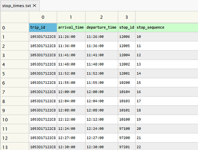

Here's what the shop_times.txt file look like:

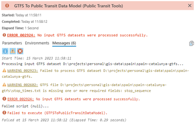

And yet ArcGIS Pro is telling me that stop_sequence is missing:
DanPatterson
MVP Esteemed Contributor
Try converting the text file to a geodatabase file.  Pro may allow you to view a text file as a table but processing tools may not recognize it as a datasource with fields

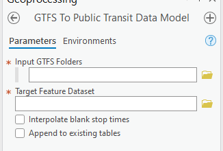

I added the files as tables:
But the tool wants the folder with txt files:
