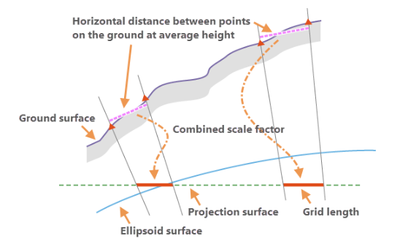

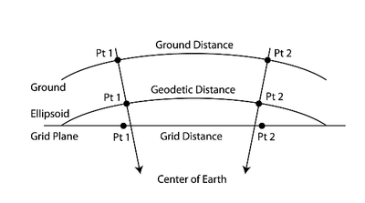

Hello,
I have drawn a line in a specified state plane coordinate system map and feature class.  Now I would like to label/report the ground distance and azimuth of this line.  Is there a stock geoprocessing tool for calculating grid to ground distances and directions?
Thank you.
Tyler

It seems you drew the line in state plane coordinate system; the Shape_Length of the line should be the ground distance. Otherwise, I am not sure what you meant by ground distance.
TylerT
The line is in Grid Distance (ie. State Plane Coordinates).   I need to report back ground distance or what we would actually measure on the ground.
TylerT
I could calculate it, but it's safer to use a tool that's been developed and QC'd.  I'm just not seeing any tools at first glance.
