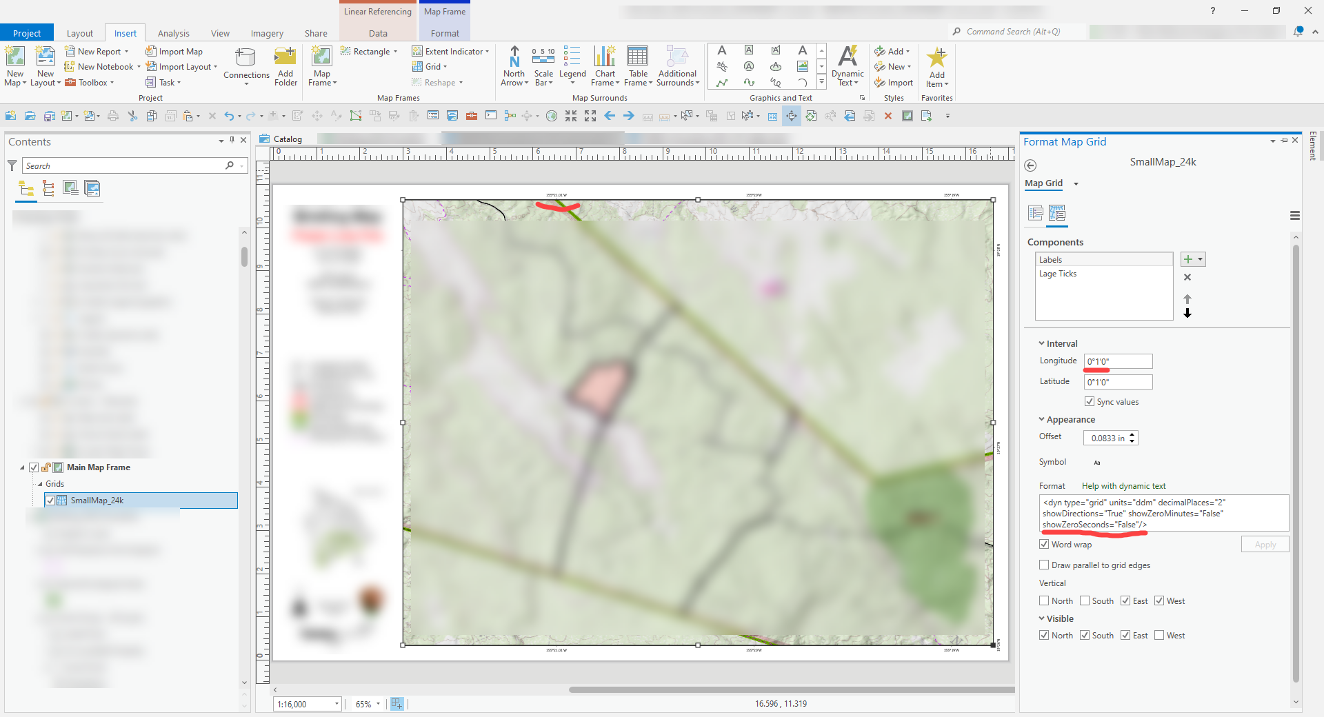

Graticule interval set to 1' but one label displaying X.01'
1585
07-16-2022 12:14 PM
CA_NC_-_MarkWasser__GISS_
Why ESRI? Why?! This is driving me crazy.

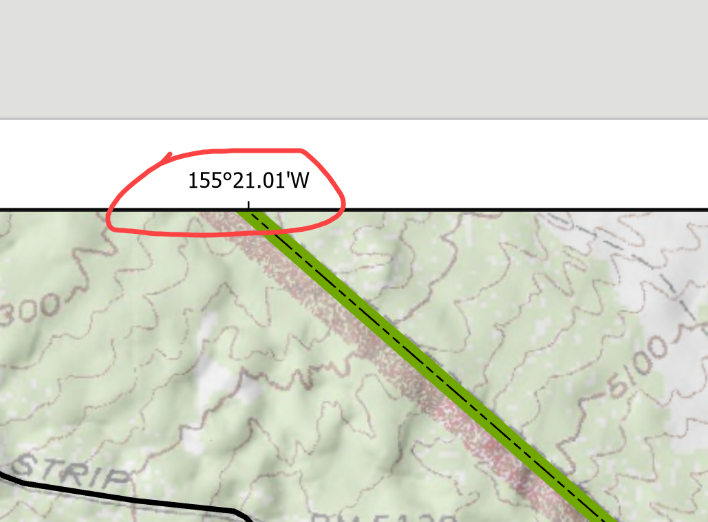

Graticule interval is set to 1' and ShowZeroSeconds = False in dynamic text.  All graticule labels are correct except one longitude value which displays XX° XX.01'. Tried changing map scale by very small increments, doesn't help. ArcGIS Pro 2.9.3 (3.0 not an option for our org at the moment).
CA_NC__MarkWasser__GISS__0-1657998814068.pngCA_NC__MarkWasser__GISS__0-1657998814068.pngCA_NC__MarkWasser__GISS__1-1657998834143.pngCA_NC__MarkWasser__GISS__1-1657998834143.png
AubriOtis
Have you tried changing the number of decimal places to 0 instead of 2? That might fix it.
Cheers,
Aubri
TomBole
Hi Mark
This issue sounds very similar to known issue - BUG-000142703 Grid graticules in ArcGIS Pro layouts show incorrect labels at specific intervals.
Tom
