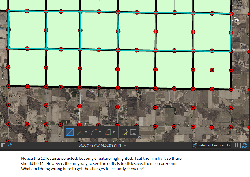

I am attempting to edit a new feature class created in a file geodatabase.  What is vexing me is I draw a polygon or I cut one, and the edits are not instantaneously seen like in ArcMap.  I have to hit save and then pan or zoom to get the edit to show up.
Notice there are 12 features selected after I cut the six polygons.  There are only the original 6 polygons "selected" on screen.
I should not have to save the edits to see them.  It should work like ArcMap where you cut something or create something and you see it right way.  So what am I doing wrong? I am using 2.4.2 for Pro

That is certainly odd behavior that I can't reproduce, so I have a few questions:
  1. How did you create the feature class? In Pro?
  2. Does the same issue occur for another feature class in the same file geodatabase, how about a different file geodatabase, how about a new file geodatabase?
  3. How are you cutting the polygons? I'm assuming with the Split tool?

I created the feature class via pro, by going to a folder on our network, right clicking to make a new file geodatabase, create a feature class.
Same issue in the same geodatabase, and in the other two test ones I set up on my C:\ Drive and the other is the geodatabase the project created.
I used the split tool, but is also does it for just creating a feature from stretch.

Thanks for trying those other scenarios, David. I'm having a hard time understanding why this would happen. Try clearing the local cache in Options > Display to see if that makes any difference:

It looked like the clearing of the cache worked.

Is the cache setting that worked for you to set Clear Cache to be checked which means the cache is constantly being cleared?
DavidBuehler
Michael,
It is now.

I'm just following up - have you seen this problem again since the first time? If so, do you frequently work with new feature classes in a File Geodatabase that is stored on a mapped network drive location? If that's the case, we were able to reproduce the issue in this specific scenario. The good news is that it should no longer occur in 2.5 (coming soon).

Hello - Funny thing, after googling this problem, I stumbled across this thread. I can report that I am experiencing this exact issue, while making edits to a FGDB on a mapped network drive. After clearing my display cache, it appears to be working as intended.
Anyway, it sounds like the issue will be resolved with 2.5, but I just wanted to throw my hat int he ring as someone experiencing this issue.
