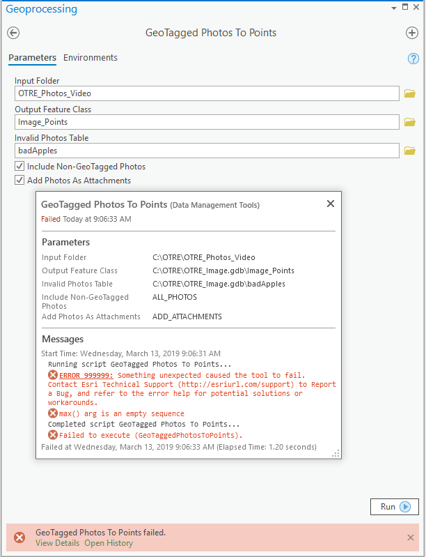

First time ever using this tool and it bails out with the infamous Error 999999 Something unexpected.....
But the max() arg is an empty sequence is interesting.  I tried with and without checking Include Non-Geotagged Photos and Invalid Photos table, but get the same error....
Ideas?
That should just about do it....

I get the same error in ArcMap 10.6.1....

I have this working fine in Python 2.7, FYI.

Do the images have to be jpg?  These are all png.....
edited to add:  sure enough; jpg or tiff only.  From the help:
This tool reads the longitude, latitude, and altitude coordinates from JPEG and TIFF photo files and writes these coordinates and associated attributes to an output point feature class.

The folder I read from has only .jpg.
