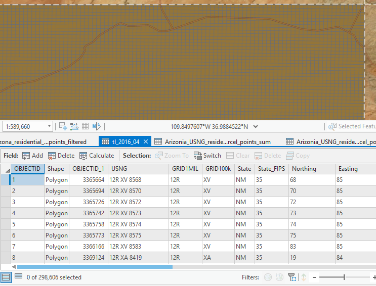

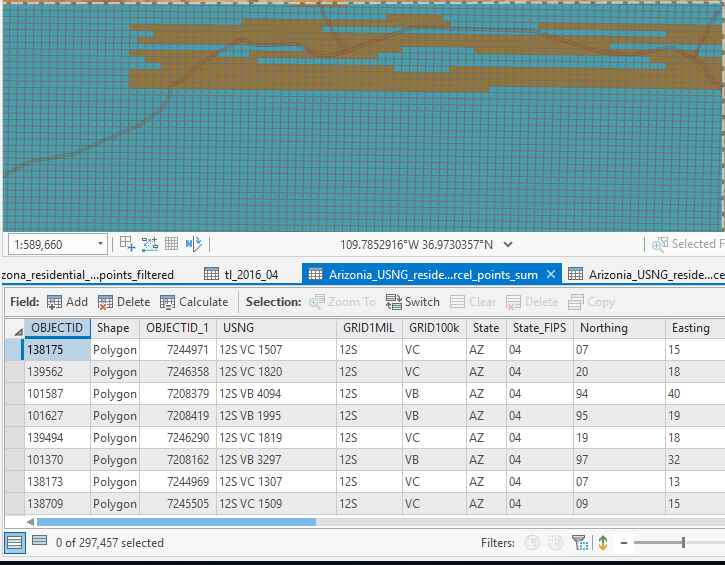

I have a polygon shapefile of 1 KM USNG grid cells that make up the state of Arizona, it is 298,606 features. I run a summarize within geoprocessing tool for a point layer of 2,303,507 residential parcel points in order to find the number of homes in each 1 KM grid cell. I select "keep all input polygons" as I want to know the grid cells without parcel points as well as those that do.  Each time I run the summarize within, the process completes and I can visibly see features are missing from the new layer compared to the original USNG grid layer. Opening the attribute table for the new layer it will at first, state it has the same number of features as the original (298,606) but after sorting the data, it resets and reads the real values : 297,457 or 296,553 the last two attempts I had made for the tool. I am uncertain what is the cause of it repeatedly omitting some values.

original data:
summerize within originial
original data in brown, new data in blue, missing summarized values seen in areas appearing brown, missing values in attribute table.
summerize within geoprocess fail
