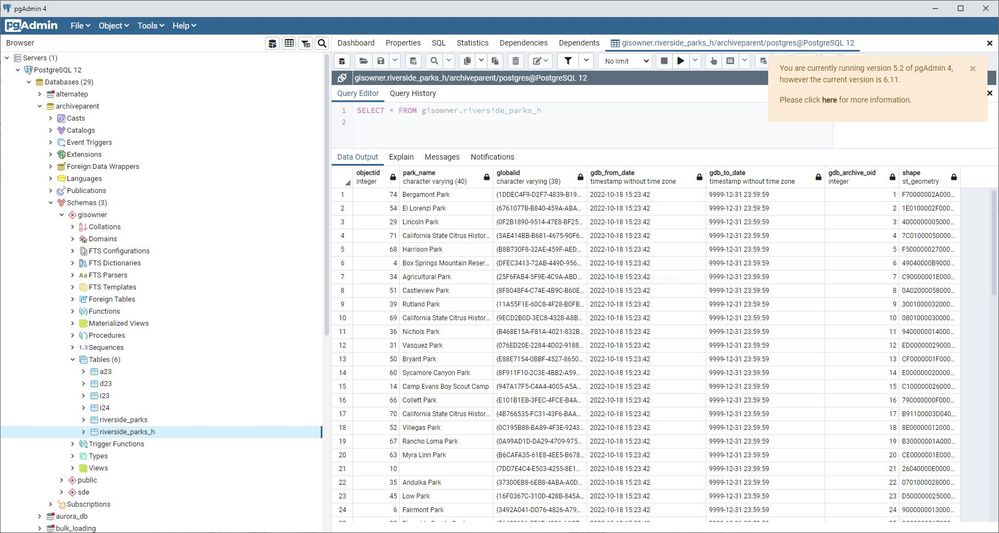

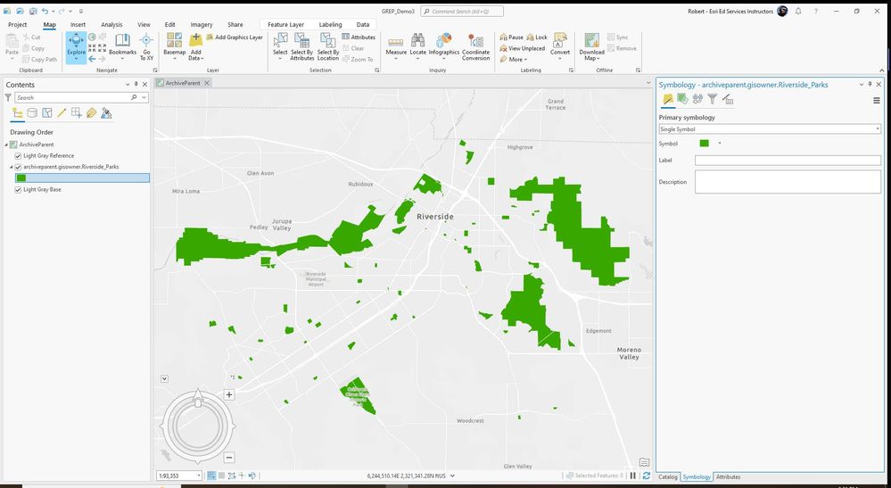

So walking though my images, I have archiving enabled on a parks feature class and the archive class is created riverside_parks_h that I can see in Pgadmin (using PostgreSQL for my RDBMS).

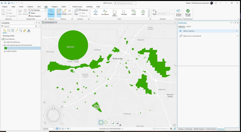

I return to ArcGIS Pro and set up for an edit - going to create a new park (circle).
Add the new circle park - Robert Park and do a save for the edit. Transaction time recorded is the computer clock time as like ArcMap.

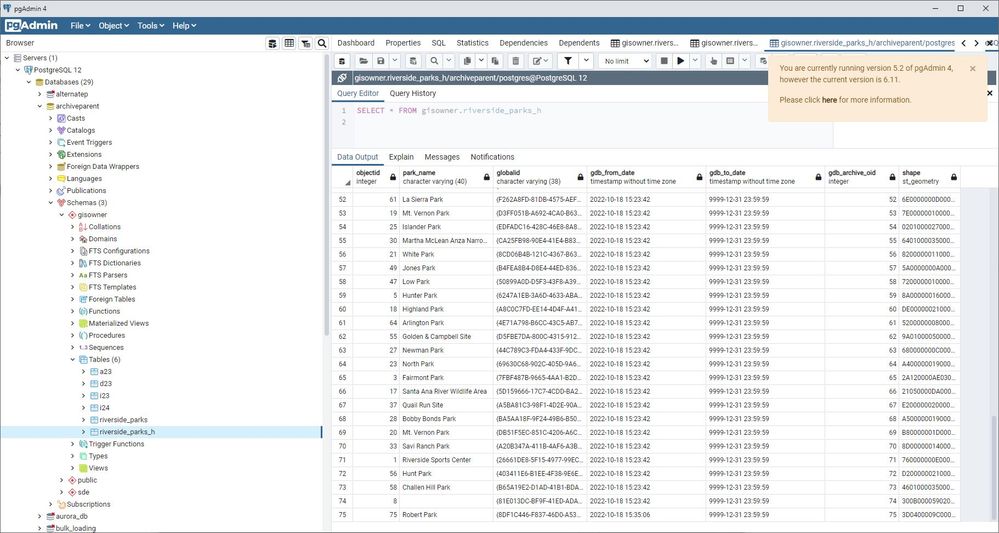

This is seen in the archive class in Pgadmin

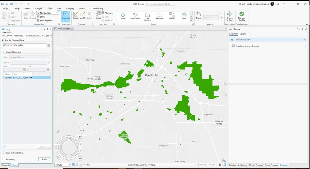

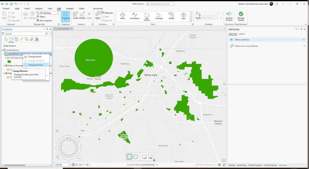

I return to ArcGIS Pro, click list by data source, right-click on the default version and click "Change Moment" - this opens the History Pane.
And then when I want to work with the archive class in ArcGIS Pro, I use the History Pane to view points in time with the data and apply those dates/times.
