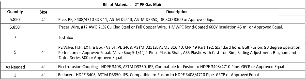

I am trying to format a legend in ArcGIS Pro to look like a table. Essentially, all I need is to add lines between each item and between the items and their descriptions. This is a template for a map that will change frequently so I want the table to adjust size when the descriptions for the items change. If it was static I would simply draw the lines in.
This is the table I'm trying to approximately replicate:

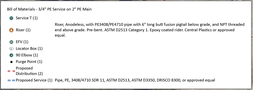

This is as close as I have been able to get so far:

Im not sure you'll be able to get the legend to do what you need, but have you thought about just adding an accompanying table to the layout? With word wrap enabled, it will update the rows dynamically for you if required.
