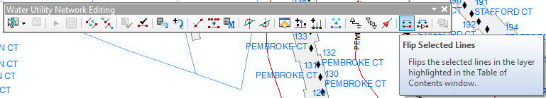

In good old ArcMap, there was a "Flip Selected Lines' tool on the Water Utility Network Editing toolbar that flip all selected lines from the layer of your choice.  It was utility-network-agnostic so you could flip all selected lines from any feature class.
Where is the equivalent feature in ArcGIS Pro?  The ESRI instructions here don't work because "Reverse Direction" is grayed out.  I can flip a single line using the Edit Vertices tool but I have many to flip.

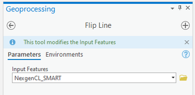

Does the Flip Line tool work for you?

Thanks @JohannesLindner .  This tool was so easy that it actually confused me.  I saw this before I posted my question but I was afraid it would flip all features in the feature class (I guess because I didn't see the option to flip all or flip only selected - I should have tested it on a dummy layer).  With just some features selected, it'll flip just those features.
Robert_LeClair
Esri Esteemed Contributor
PLadd - the reason the Reverse Direction command is grayed out is that workflow requires a Standard or Advanced license.  Same licensing requirements for the Flip Line GP tool that Johannes mentioned.  What is your licensing for ArcGIS Pro?
