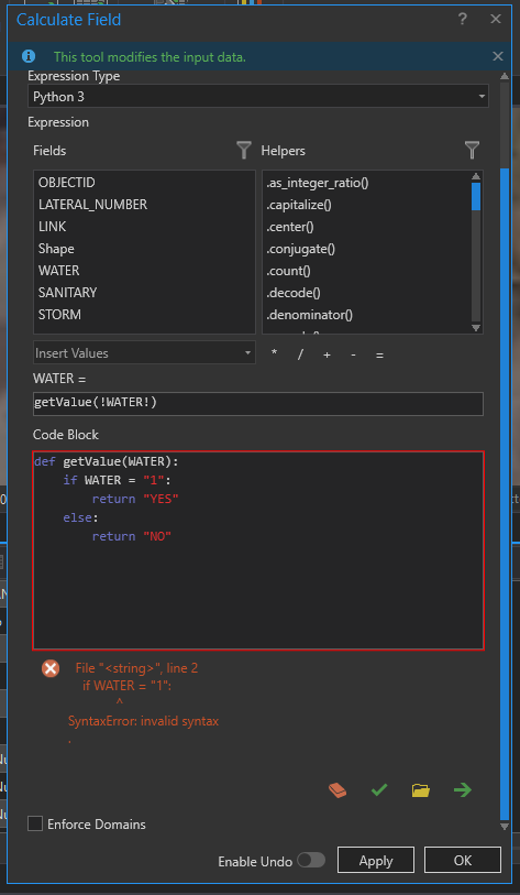

Hi,
I'm trying to update the field "WATER" with new values.  We have just created a proper YES/NO domain for this field, so I want to update the existing 1 or 0 value to the proper domain value or "YES" or "NO".  Can anyone explain what might be happening with this error I am seeing.  I am a total NOOB to Python.
Tags (2)
JaredPilbeam2
MVP Alum
You need to use 'equal to'. You have 'equals'.
if WATER == "1":
JaredPilbeam2
MVP Alum
if WATER == "1":
BrianBulla
Honored Contributor
Ah....of course!  Thanks!!
