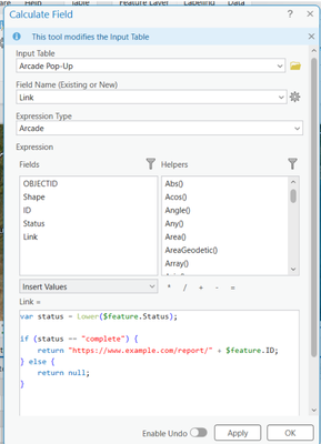

Step 1: A Calculated Field in ArcGIS Pro
Build the report URL: You may also export this calculation for use in other projects.
Example URL where the report ID is the variable: https://www.example.com/report/1
Example Arcade expression used in the field calculation:
var status = Lower($feature.Status);
if (status == "complete") {
    return "https://www.example.com/report/" + $feature.ID;
} else {
    return null;
Note: If the variable identifier is not at the end of the URL, concatenation can be applied using:
"https://prefix" + $feature.ID + "suffix.com"

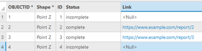

Status‑driven conditional links: Only records with a status of complete return a constructed URL. All other records explicitly return <Null>.
  • Evaluates record status
  • Decides whether a URL exists at all
  • Returns <Null> when conditions are not met
  • Prevents invalid links from ever being published
