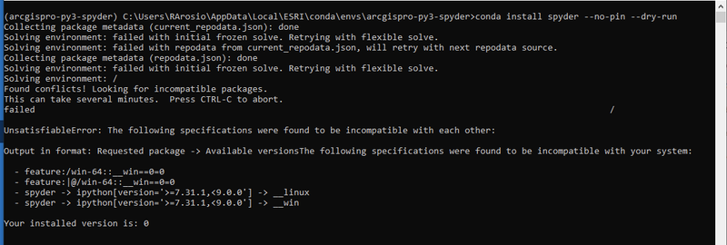

Hi all
I have recently updated ArcPro to ArcPro 3.1.0 but now I am having issues re-installing Spyder. I have made a "clean" ArcPro uninstall (https://esribelux.com/helpdeskitem/clean-uninstall-of-arcgis-pro/) and tried to install Spyder again (using "conda install spyder --no-pin --dry-run" first, as Dan Patterson suggested, https://community.esri.com/t5/arcgis-pro-questions/arcgis-pro-2-9-2-unable-to-install-spyder/td-p/11...) but still having troubles. Any idea on what is going on?

DanPatterson
MVP Esteemed Contributor
There are issues with esri's supported versions of ipython/jupyter_client.  You are missing ipython from initial appearances, so esri has an older version of spyder on the esri channel so if you want 5.1.5 then drop the --no-pin and try it in your clone.
I on the other hand, used a  ... pip install spyder ... to get spyder=5.4.1 installed (which isn't recommended, but I really don't care)
Spyder install - Esri Community
others have given up
Script Editor in ArcPro 3.1.0 not honoured, help! - Esri Community
I can't wait until people want pandas 2.0
... sort of retired...

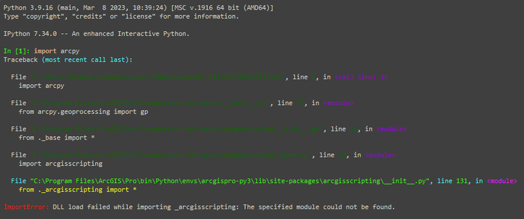

RArosio
Hi Dan
thanks for the help. In the meantime I followed another advice of yours in other posts and installed spyder in the base environment. It worked, but I cannot import arcpy... I will try with 5.1.5 in a clone.
RArosio
Even with pip arcpy cannot be imported...
DanPatterson
You have other issues then.
I would recommend a complete uninstall of Pro.
Rename any esri related folders in your c:\users\.... local  pathway
Rename any esri related registry entries
eg.  a clean slate
Install Pro, create a clone, try to install spyder using conda (skip no-pin for now) and see if that works.
