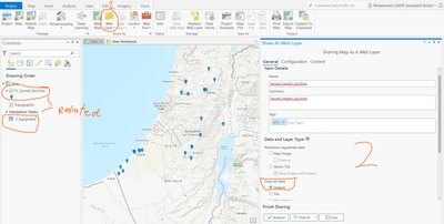

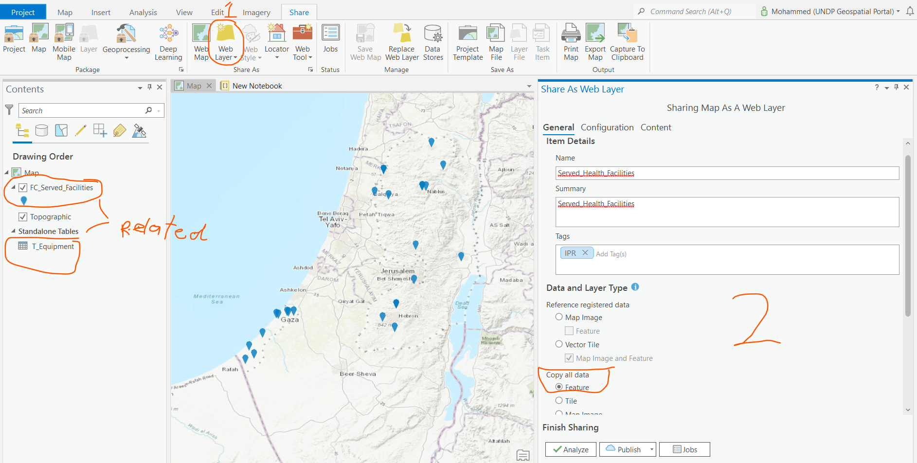

I have a problem of publishing hosted feature layer from ArcGIS Pro to our Portal on ArcGIS Enterprise.
The steps I used is shown in the following screen:

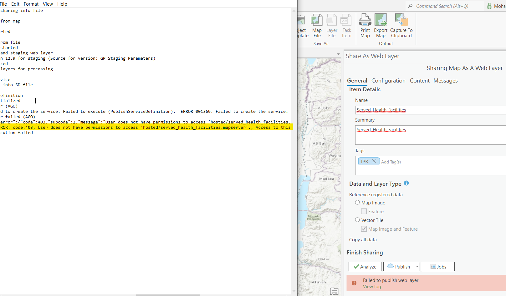

The error I got is here:
The error is:
"Server Response: ERROR: code:403, User does not have permissions to access 'hosted/served_health_facilities.mapserver'., Access to this resource is forbidden, regardless of authorization."
Knowing that I publish a feature class that is in relation with another table through relationship class in the project Geodatabase as shown in the first screen.

StatusMessage: Server Response: ERROR: code:403, User does not have permissions to access 'hosted/cable.mapserver'., Access to this resource is forbidden, regardless of authorization.
Several folks in my organization receive this error when attempting to overwrite or publish a service in Enterprise 11.3 using ArcGIS Pro 3.3.0. After the error is thrown the existing service is corrupted and must be recreated. I'm simply adding to the list of people that have encountered this error with no solutions.
