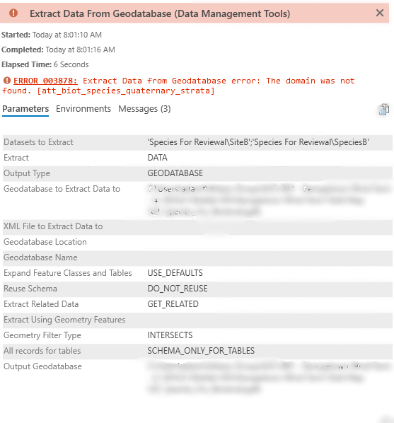

When I try to run the tool with just my selection I get Error 003837: Extract Data from Geodatabase error: The domain was not found.
That domain exists from where I am trying to extract data from so not sure why there is an issue.
I noticed the intersect tool only works with polygons, if it worked with points that would have been enough.
Anyone have a better recommended way to export with associated records?
