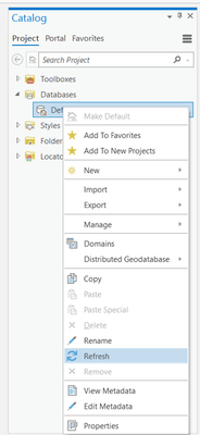

Hi @SarahBlake,
The behavior you have described does occur occasionally, whereby the data will not immediately appear in the expected location. As you have identified, the solution to this is to navigate to the Databases folder within the Catalog pane, right click on the .gdb and select Refresh.

SarahBlake
Aah - I may be answering my own question...I didn't realize there is a separate 'Refresh' button in the Catalog tab, Organize group...I had been using the 'Refresh' when in the map view.  I just tested the process doing another export to my project.gdb, then the correct 'Refresh' and there it was!
