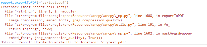

Error as shown in the below screenshot:
Error
I have tried with different systems, and even tried granting full access but no success.
Appreciate if anyone has faced this issue and can provide some workaround.

ManishPatel
Hi Arne Gelfert,
Thanks for the suggestion, it seems there environment issue, when I tried to use a different location it seems to be working fine.
