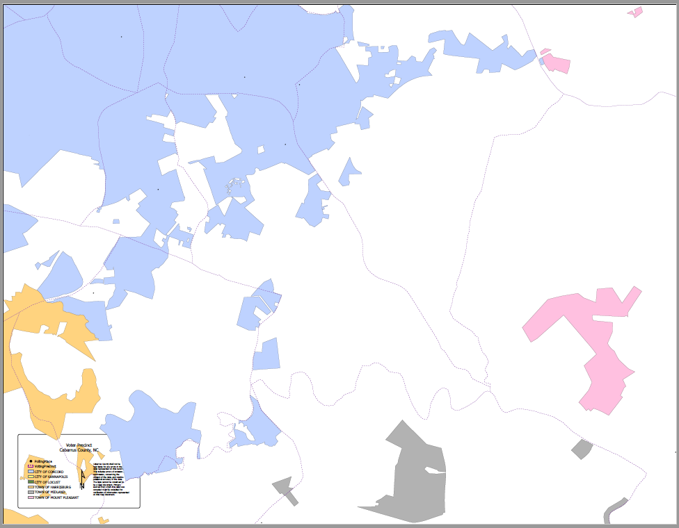

Trying to print this layout which is sized at 34"x44" (ANSI E) within ArcGIS Pro 2.8.3.
But when using Export Layout to a PDF on a local drive using default settings, my PDF looks like this:

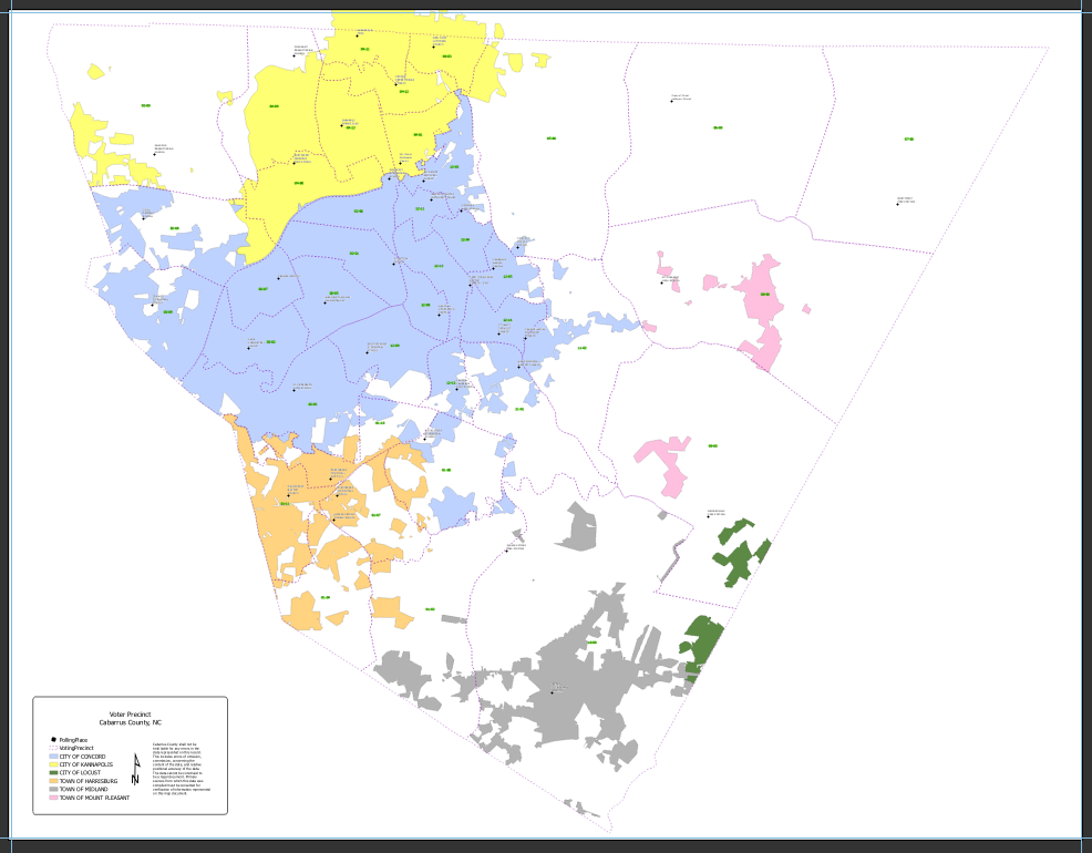

When my coworker does the same at ArcGIS Pro 2.6.x using a project package I exported, it prints without issue and looks as expected. Can anyone confirm whether this is a bug with 2.8.x?

Is it possible you have a map series enabled on your layout? That's the only reason I can think of for the extent changing.

Thanks for the response on this. Nope, map series is disabled.
AubriOtis
That's really odd. I've never seen anything like it, it looks like a bug. I would recommend reaching out to tech support, as they can take your case and get it to the appropriate development team to fix. https://support.esri.com/en/contact-tech-support

Was there ever a fix for this? I am having this problem with every layout that I print to PDF and its driving me crazy
KeithFrench
Go into the Map Frame properties and click on the Display Options tab (the second from the left).  At the bottom is a box labelled "Extent..."  Click on that and in the "Get extent from:" box, click on "Current visible extent."  Verify that the extent matches what you want to export.
