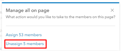

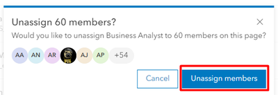

SamuelCanas
Hi Mick,
I´m glad you solved the issue! If this happens in the future, there might be a way to do it without having to check manually on the 1k+ user list. When managing the extension, you could try clicking on the option that says: "Manage all on page".
And then "Unassign members"
This action will apply to all the members whether is assign or unassign.
I hope this information can be helpful if situations like this happen on the future.
