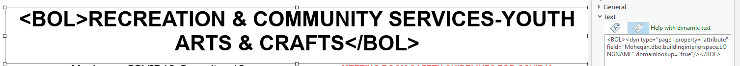

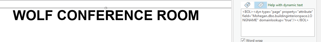

Yes - the dynamic text works just fine until I add some formatting tags like <FNT></FNT> or <BOL></BOL>
Displays As Intended:
Displays Incorrectly (Dynamic Text contains "&"):
Try adding some formatting tags to your dynamic text and see if you experience the same.

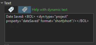

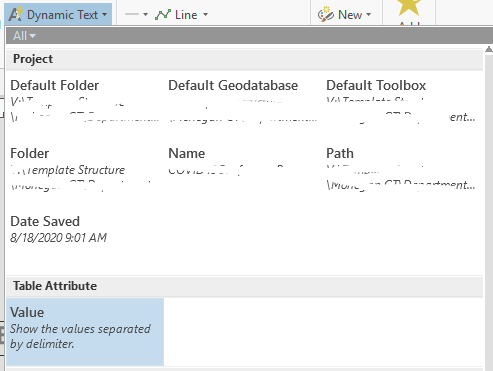

Inserting format tags within the dynamic element is not supported. You can place formatting tags around the dynamic tag. For example, here is a dynamic text element for the date the project was saved. You see static text - "Date Saved:" and a dynamic tag - "dateSaved".
If I want the date to be bold I can add formatting tags around the dynamic tag.
Here's how the element looks in Text View.
The dynamic part of the element is prefaced with "< dyn type=". Within this dynamic tag you see its parts - <dyn type="project" property="dateSaved" format="short|short"/>. This particular dynamic text element provides a format option.  This allows me an option to show only the date.

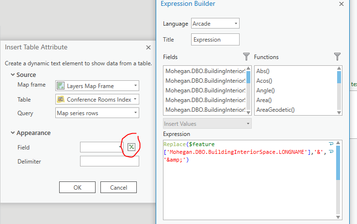

Ok - I think with your direction I was able to use Arcade to escape the "&" by inserting as Dynamic Text-->Table Attribute".  Here is where things get a bit misleading:

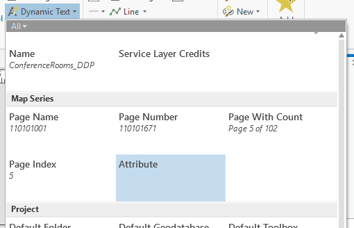

What I had done previously is insert an attribute by going to "Dynamic Text-->Map Series-->Attribute
Then from the dialog I selected the attribute I wanted to add to the layout:
What I have found is by going this route, there is no dialog to format the dynamic text.  It simply inserts the text "as-is".

If I insert dynamic text from a table attribute, The ability to insert formatting expressions (i.e. replace the "&" with the HTML equivalent) using Arcade is available:
