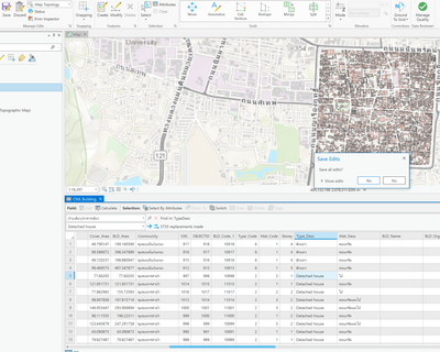

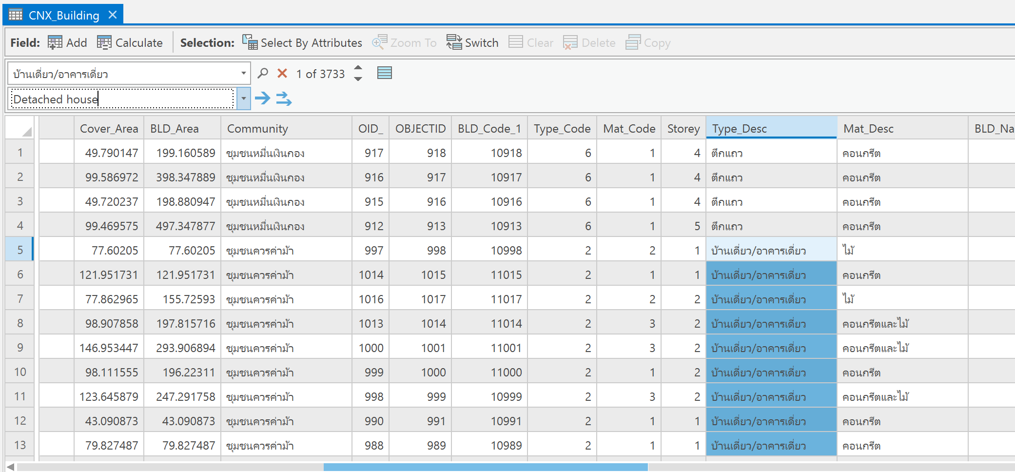

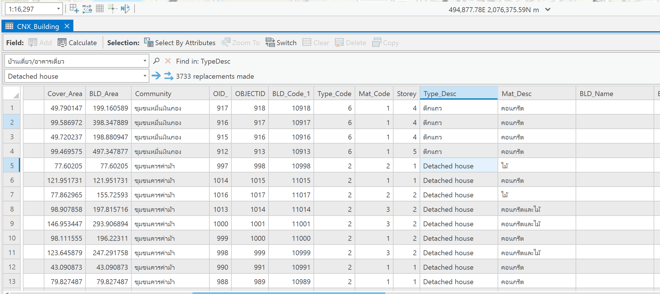

I am using arcgis pro 2.8.  I changed the text in attribute of shapefile using replace function in attribute table.(figure 1-2).

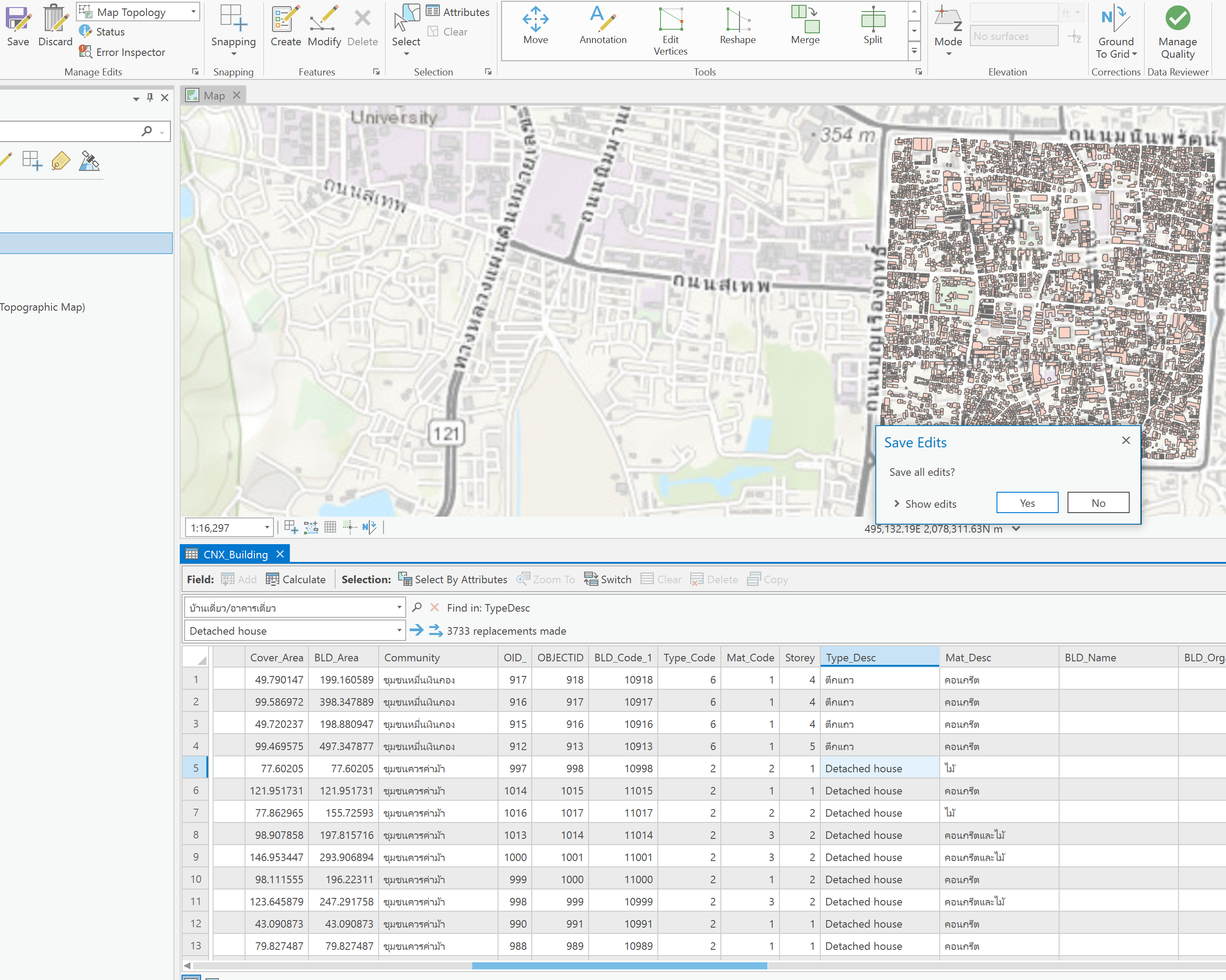

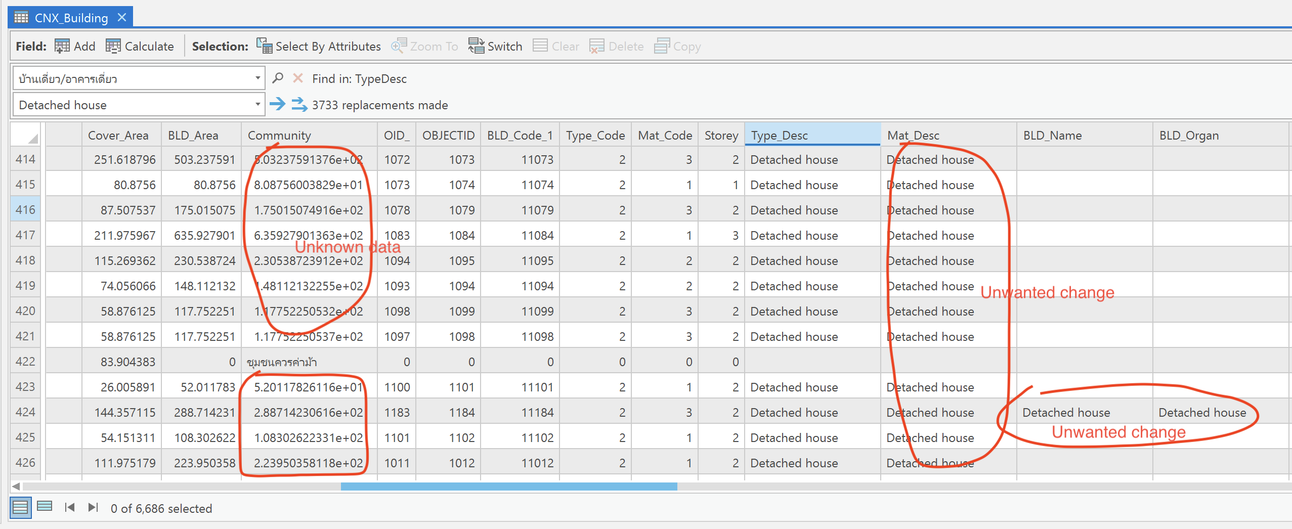

The replace worked perfectly without any problem. (Figure 3.) but when I save the edited feature, my table data was ruined. The unknown data overwrote the other row of data and it randomly wrote the other empty rows with changed text. (Figure4-5).

the dbase portion of shapefiles have poor support for unicode characters.
Do you remember the "replace" syntax that you used?
Geoprocessing considerations for shapefile output—ArcGIS Pro | Documentation
support article
How To: Read and write shapefile and dBASE files encoded in various code pages (esri.com)

Thank you very much for pointing out. I just exported the shapefile>geodatabase. It's work like a charm. Sorry for my outdated skill. Silly me.😅
