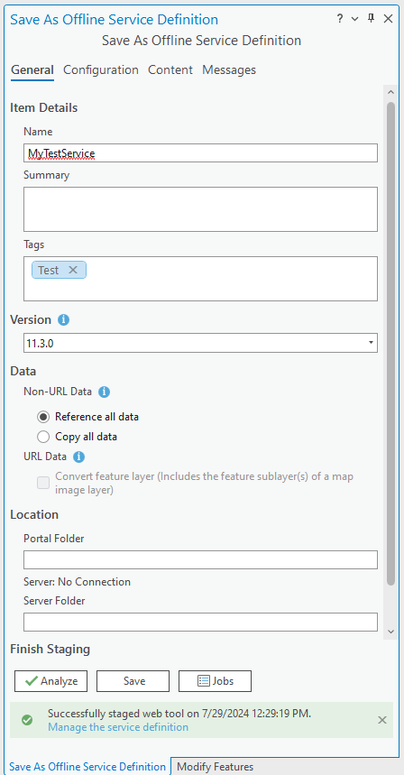

Note: I also tried using the Save As Offline Service Definition tool:

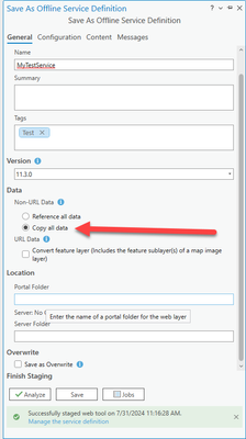

4. When the stage definition is created, is very important  to select the Copy all data option (in ArcGIS Pro):
or its equivalent  in python: setting True the property copyDataToServer in the GeoprocessingSharingDraft class.
when all this is set, the creation of the .sd file will consolidate, and the file structure will be:
