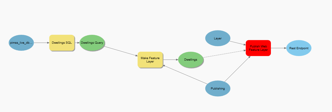

Below is a diagram of my model:

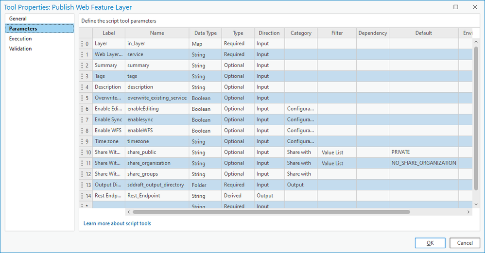

Below are the parameters I used as per the Esri article:
