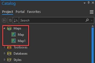

Is it possible that you have other maps in your project that do not contain layers? On the Catalog pane and under the Project tab, under Maps – can you check to see if all your maps have at least one layer?

Thanks for some input JonahLay;    I checked and all maps have at least 1 layer, usually quite a few.
