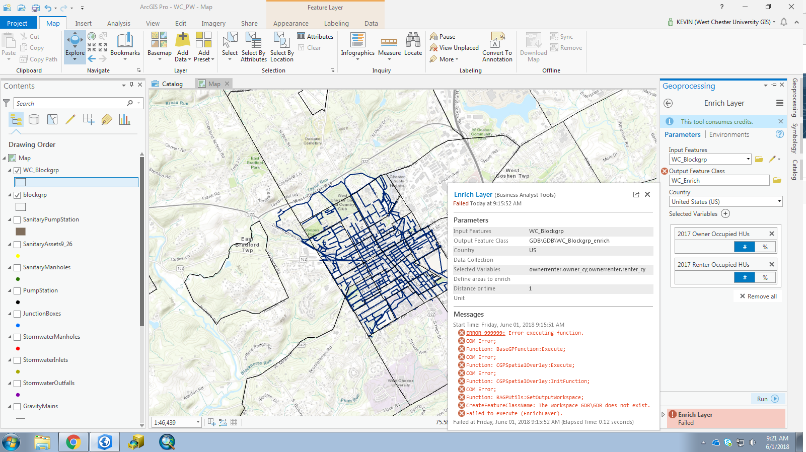

So i am trying to get data on local housing- owner/rental, I am using a blockgrp layer which i have used in the past but on BA desktop. This is my first time trying it on ArcPro. I keep receiving two errors-The first error is before i run the tool, and it tells me that my output location doesn't exist but i'm using the gdb. that my project is running off of. Secondly when i bypass the first error it tells me that my "workplace" does not exist? This seems much more complicated compared to business analyst. Any Ideas??

MarcoBoeringa
MVP Alum
Looking at the screenshots you posted, I notice the file path to the File Geodatabase contains an extra "." dot character in a subfolder of the folder path:
"ArcPro Misc.Work"
This is just speculation, but it might be that ArcGIS Pro, and particularily this tool, trips over this dot character in the file path. It doesn't always, because I have had situations like this myself where Pro happily accepted the extra dot character, but it might be a cause of the failure in this particular tool.
You might at the very least attempt to remove it to see what the tool does.

Unfortunately it still didn't make a difference. But like i stated in my last post from yesterday i was able to get the enrich tool to work by accessing it from top tool tab instead of accessing it from the BA Analysis tool box. Thanks for the input.

Option 1
option 2 (original problem)
