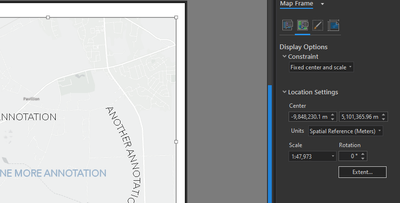

Lastly, if you have "fixed center and scale" enabled on your map frame, it will not zoom or pan when activated. "Locking" it just prevents editing of the element itself. And while the normal panning/zooming commands will be specific to the map, you can still use the scroll bars to move the layout around while a frame is active.

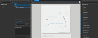

I have one addition that should help. You can press the "1" key (not the one from the number pad, but the one underneath the F keys) to navigate the page layout with an active map frame.  This will allow you to zoom/pan the page without changing the map extent.

To keep the map frame extent fixed try setting a map frame constraint
