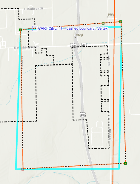

As of yesterday, when I try to edit vertices on a polygon, it causes the whole polygon to tilt.  I cannot move just one vertex.
edit vertices tilts polygonedit vertices tilts polygon

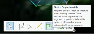

@LoriEmersonKDOT  Please check the Edit toolbar and toggle off Stretch Proportional.  It is on the toolbar and in the backstage options if you have turned toolbar visibility off.

Thanks so much @JenniferCadkin .  Once I toggled off the Stretch Proportional, editing vertices worked.
