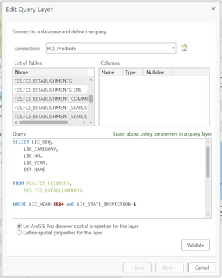

I am accessing an old oracle database that contains many different tables and lookup ID fields.  I'm trying to use one big select statement in a standalone table source edit query layer to  combine the data I need into one usable table that I can then geocode within ArcGIS Pro 2.0.7.
There is a zip code lookup field in one of the main tables called LOC_ZIP_SEQ.  This lookup field is null in a couple of the records that I need. I only have read only access to the data so I'm unable to change the original data table and I still need to incorporate those records with null values.
The WHERE statement LOC_ZIP_SEQ=ZIP_SEQ should in theory return the corresponding ZIP_CODE value, but it effectively filters out the records that contain the null lookup field.  I do get all the other records. So the rest of the code is working as intended.
I've tried constructing the WHERE statement like (LOC_ZIP_SEQ=ZIP_SEQ OR LOC_ZIP_SEQ IS NULL), and other similar arrangements, but I I get an error that says failed to retried a page of rows.
I feel like this should be basic SQL 101, but I'm out of ideas so any input would be great.
Thanks!
Erik

SELECT LIC_SEQ,
	LIC_CATEGORY,
	LIC_NO,
	LIC_YEAR,
	EST_NAME,
	LOC_ADDRESS_1,
	CITY_NAME,
	ZIP_CODE,
	OWNR_NAME
FROM FCS.FCS_LICENSES,
	FCS.FCS_ESTABLISHMENTS,
	FCS.FCS_LICENSE_OWNERS,
	FCS.FCS_LOCATIONS,
	FCS.FCS_CITIES,
	FCS.FCS_ZIP_CODES
WHERE LIC_YEAR=2024 AND LIC_STATE_INSPECTION=1 AND EST_NO=LIC_ESTABLISHMENT AND OWNR_NO=LIC_OWNER AND EST_LOCATION=LOC_SEQ AND LOC_CITY=CITY_CODE AND (LOC_ZIP_SEQ=ZIP_SEQ OR LOC_ZIP_SEQ IS NULL)
I was using a select statement without a join.

Is there a more specific resource for this method?  I have looked at some of the ArcGIS Pro references for queries, but I haven't seen one that uses the join.  I've tried using the "Join" as suggested above and it breaks the code.
https://pro.arcgis.com/en/pro-app/latest/help/mapping/navigation/sql-reference-for-elements-used-in-...
LeighErik
This only seems to accept standard select query syntax.
