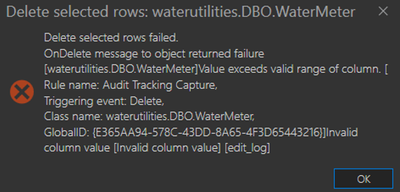

@ZachBodenner We currently receive a "Value exceeds valid range of column" error on deletes. We occasionally notice the error come in on the update trigger while editing 12+ fields in Field Maps before hitting submit. Any idea what this could be?
ZachBodenner
MVP Regular Contributor
Usually that's something to do with the length of the field (ie. your string field can contain 500 characters, but what you're attempting to write in has 501 or more characters).
Happy mapping,
- Zach
tbearb
That was exactly it, we just needed to increase the length of the text field.
