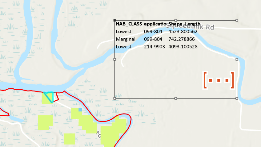

Have a map series with some Habitat Likelihood data over some property polygons. Have a table to display the acres and percentage of the total property acres. Have two properties that were acting oddly, one is a multipart that has a little notch in the the other one:
So this table should only be the 099-804 property. I've clipped the habitat polygon (the yellow) so there is no overlap and the attributes have the separate numbers. I just dont know why this is still showing up, any ideas? Tried resetting the map series, setting page definitions and nothing seems to work.
Is the Table Frame Query based on attributes or the extent of the map series feature?

Hi,
What query are you using for the table? Map Series rows or Visible rows?
