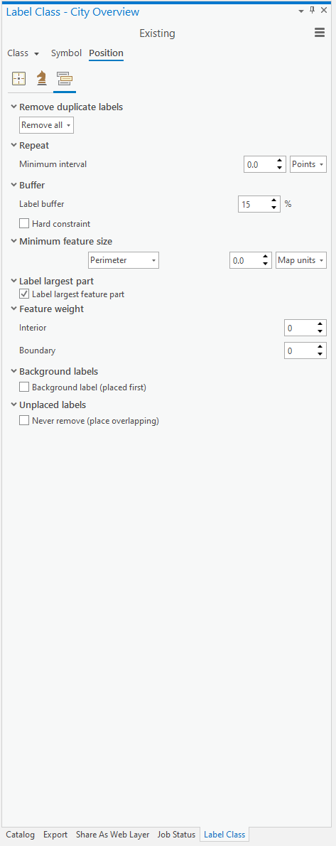

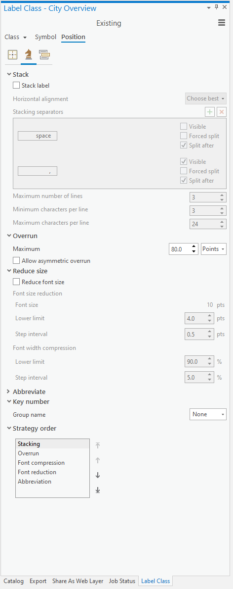

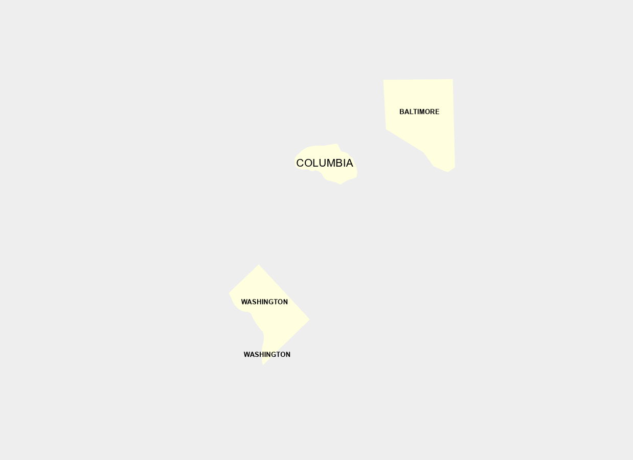

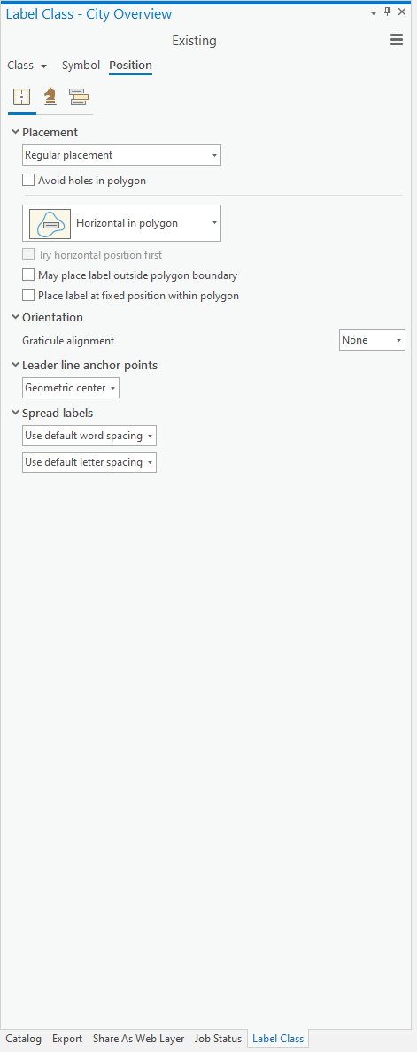

Trying to push a may to ArcGIS Online using ArcGIS Pro. Each time I process the share to online it shows duplicated values. I am publishing it as a Hosted Tile Service as I have customized symbology. I tried exporting as its own layer rather than a map and it happens again.
Below are my settings currently being used for labeling of this Layer and Class.

No.  The viewers made no difference for me either.  Just testing different workflows.  For the map viewers, I published a web map vs. a tile layer to test.  No duplicates via sharing as a web map.  Then shared it as a web layer as a tile layer and one as a feature layer.  The only time duplicates show is the tile layer.  Hence me thinking it's related to the BUG I listed in my initial reply.
jcarlson
MVP Esteemed Contributor
It would appear that generating tiles evaluates rendering settings per tile, almost as if you were doing a massive map series, or were repeatedly panning your map and exporting.
The label placement is just in the center of the portion of the feature which is visible. In Pro, this will render a label down near the edge of a polygon if most of it is out of frame. Looking at the individual images created by the tile pack, there is a cut-line between tiles where you're seeing this issue.
I'd say it's a feature, not a bug, and a cautionary tale to really getting your rendering settings carefully configured before exporting to a static format like tiles.

@Robert_LeClair has there been a status update to BUG-000116520? I am experiencing the same label duplication and tried making adjustments to attempt resolve the issue before finally stumbling across this thread. I've also noticed that the label stacking settings I have applied in ArcGIS Pro (using maplex) are not properly displaying in my hosted vector tile layer once it is uploaded into ArcGIS Online. In ArcGIS Pro, I have spaces set as stacking separators with a maximum number of characters per line set to 12, but the hosted vector tile layer displays those same labels with multiple spaces in a single line of 20 or more characters. Is that a known issue that is included in the same bug?
